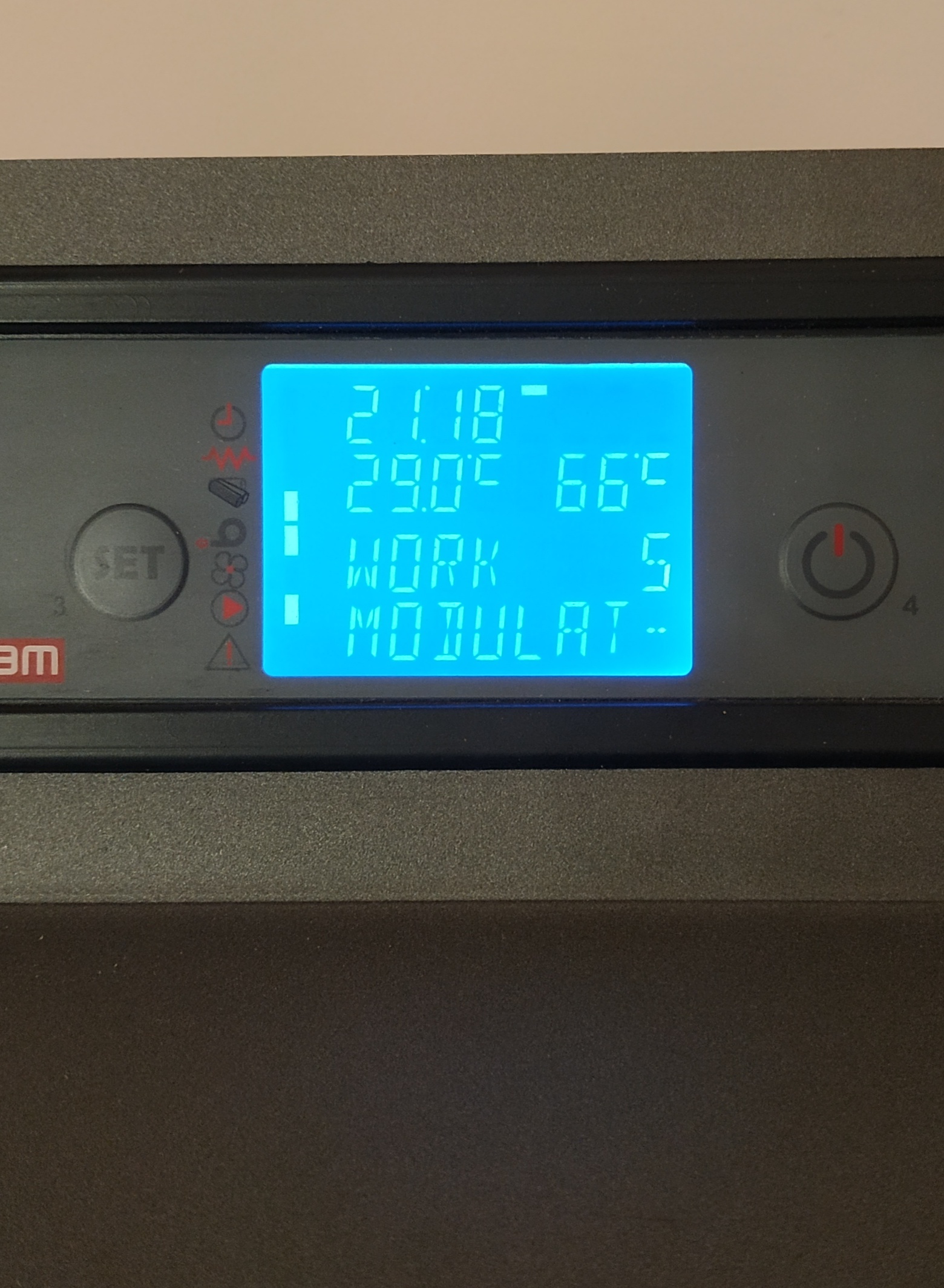

Всички Т глави са ми на 4,5-2бр и 3бр на 5/на макс/ и ето резултата цял ден погорява с кратки прекъсвания , цял ден е на първа при авто режим

Кво стана колеги? Оправихте ли проблема с въздуха и с почасовото отопление :)
kaptagona - специалист
Колеги на меню 4 и на меню 6 имаме настроиките. А на меню 5 има ли някои.Че и там пипах и не помна какво.Алфа плам15. :? А ако може някои да ги качи всичките ще е наи добре.

EVO MOJIH FABRICI PARAMETARA ZA ALAFA COOMO 15
TYPE PELET N-8-1
LOAD PELET N-8-1-01 00
TYPE CHIMNEY N-8-2
EXHAUST CHIMNEY N-8-2-01 00
BANK DATA N-8-3
KEY ACCESS N-8-3 TRAZI KOD ILI KLJUC A JA NE ZNAM
SETTINGS GENERAL N-8-4
HALT RESTART N-8-4-01 O.5'
ASP-MIN SPENTO N-8-4-02 10'
PRELOAD LIGHTS N-8-4-03 56"
WAITNIG FIRE N-8-4-04 100"
EXH-SPEE PRELOAD N-8-4-05 1800
DIFFEREN OFF AUTO N-8-4-06 04.0 STEPENA CELZIJUSA
DEL-OFF AUTO N-8-4-07 0.2'
CHANGE OUTPUT N-8-4-08 20"
EXCHANG CLEANING N-8-4-09 200U
FROZEN KEYBORD N-8-4-10 OFF
BLACK OUT N-8-4-11 30"
TIME SERVICE N-8-4-12 OFF
MODO STEND-BY N-8-4-13 02
TEST OUTPUTS N-8-5
TEST IGNITER N-8-5-01 OFF
TEST AUGER N-8-5-02 OFF
TEST EXHAUST N-8-5-03 OFF
TEST PUMP N-8-5-04 OFF
TEST EVIE-SAN N-8-5-05 OFF
TEST BLOWER N-8-5-06 OFF
SETINGS FACTORY N-8-6
MINUTES TIME-OUT N-8-6-01 24'
MINUTI START N-8-6-02 02'
CADENCE CLEANING N-8-6-03 25'
AUGER LIGHTS N-8-6-04 1,3"
COCLEA START N-8-6-05 1,1"
COCLEA POWER 1 N-8-6-06 1,5"
COCLEA POWER 2 N-8-6-07 2,0"
COCLEA POWER 3 N-8-6-08 2,6"
COCLEA POWER 4 N-8-6-09 3.4"
COCLEA POWER 5 N-8-6-10 4,0"
DELAY ARMS N-8-6-11 30"
DURATIN CLEANING N-8-6-12 60"
THRESOL MINIM N-8-6-13 40 STEPENI CELZIJUSA
THRESOL MAXIMUM N-8-6-14 200STEPENI CELZIJUSA
THRESOL BLOWER N-8-6-15 60 STEPENI CELZIJUSA
EXHAUST EN-STRART N-8-6-16 2280
EXHAUST ENGI-AVV N-8-6-17 2650
EXHAUST ENGINE 1 N-8-6-18 1470
EXHAUST ENGINE 2 N-8-6-19 1720
EXHAUST ENGINE 3 N-8-6-20 1920
EXHAUST ENGINE 4 N-8-6-21 2190
EXHAUST ENGINE 5 N-8-6-22 2680
ENCODER N-8-6-23 ON
TIME BREAKING N-8-6-24 0,2"
THRESOL PUMP N-8-6-25 50 STEPENI CELZIJUSA
EXCLUD PRESSURE N-8-6-26 ON
THRESOL PRESSION N-8-6-27 2.5b
THRESOL OF N-8-6-28 70 STEPENI CELZIJUSA
EXH-SPEE CLEANING N-8-6-29 2800
AUGER CLEANING N-8-6-30 0.5"
SPEED BLOW 1 N-8-6-31 130U
SPEED BLOW 2 N-8-6-32 15OU
SPEED BLOW 3 N-8-6-33 170U
SPEED BLOW 4 N-8-6-34 185U
SPEED BLOW 5 N-8-6-35 225U дали са тези.от сръбския форум.

Четейки назад във темата виждам, че доста хора подгряват около а някой и под 55 градуса. Бих искал да попитам това не е ли предпоставка за конденз ? Пак да кажа питам не давам акъл.
Аз във повечето време съм на 1ва степен като държи 48-49-50-51 градуса. Но не съм забелязал конденз.
RRT - напреднал
Ами аз вече почти се примирих. Ще пробвам и почасовото палене. Само стъклото ме дразни. Много много почернява. Дали ако намаля още малко вентилаторите ще се оправи?
bmahob - майстор
ср ное 21, 2018 8:01 pmkaptagona написа:
Хора кво топлите с тия 50гр....... Тотално обърквате нещата за мене....
filmatoplo - майстор
И при мен са така -няма конденз но аз съм си майстора .
