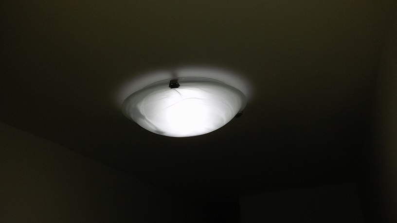

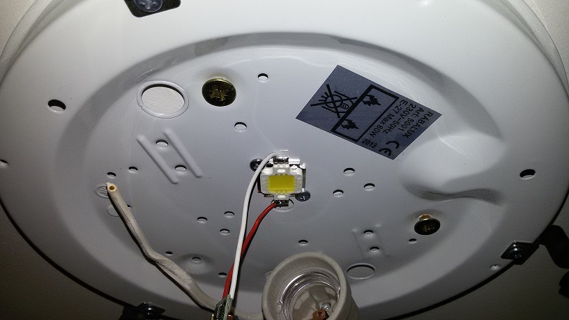

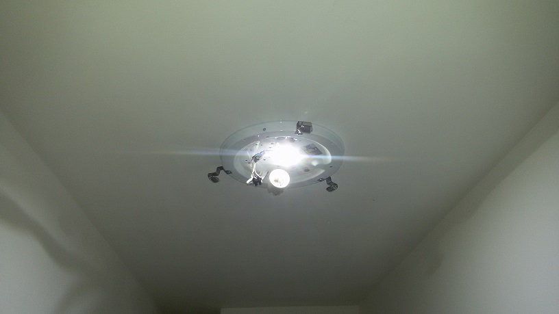

Пак с ползване на плафон и LED 10W:

Колега какъв драйвер ползваш за този 10 ватов?

В момента е с:
http://www.ebay.com/itm/1-pcs-10W-12V-2 ... Sw1x1UQSvZ
10W 12V - 24V DC LED Constant Current Driver Power 900mA
Но смятам да го заменя с :
http://www.ebay.com/itm/High-Power-Driv ... 1fjeda5-Lw
High Power Driver Supply 85-265 V Constant Current LED Light Chip Lamp
10W Driver
Driving power: 10w
Input Voltage: 85V~265V
Output Voltage: 9-12V
Current:900mA
Efficiency > 88%
Power Factor >0.98
Operating Temperature: -20~80
Size (L * W * H): 41 mm * 21mm * 16 mm
