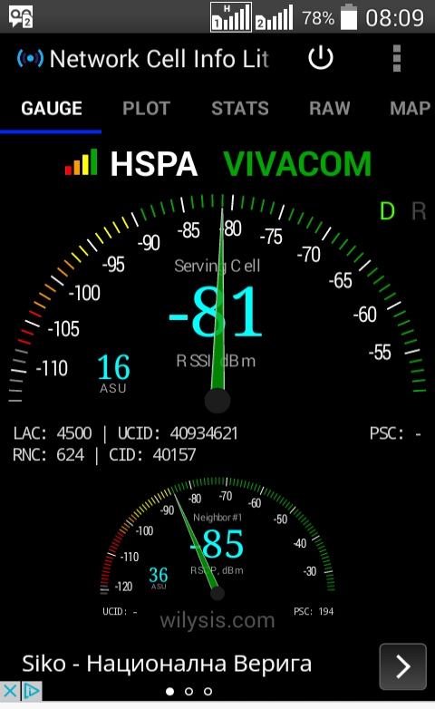

Ще съм благодатен ако някой ми разшифрова параметрите от снимката.
ASU/LAC/RNC/UCID/CID/PSC/D/R/RSSI
RSCP/HSPA и други ако има :prayer:

Acronyms:
Generic:
MCC: Mobile Country Code
MNC: Mobile Network Code
LTE (4G):
ECI: E-UTRAN Cell Identifier (28-bit)
eNB: eNodeB Identifier (20-bit)
LCID: Local Cell Identifier (8-bit)
TAC: Tracking Area Code (16-bit)
PCI: Physical Cell ID (0-503)
NID1: Network ID 1 (0-167)
NID2: Network ID 2 (0-2)
RSRP: Reference Signal Received Power
RSRQ: Reference Signal Received Quality
WCDMA, HSPA, HSPA+ (3G, 3.5G):
UCID: UMTS Cell Identifier (28-bit)
CID: Cell Identifier (16-bit)
RNC: Controlling RNC/BSS Identifier (12-bit)
LAC: GSM Location Area (16-bit)
PSC: Primary Srambling Code of Cell
RSSI: Received Signal Strength Indicator
RSCP: Received Signal Code Power
GSM, EDGE (2G, 3G):
CID: GSM Cell Identifier (for Base transceiver station (BTS) or sector of a BTS)
CDMA, EVDO (2G, 3G):
SID: System Identifier (15-bit)
NID: Network Identifier (16-bit)
BID: Base Station Identifier (16-bit)
BSLat: Base station latitude
BSLon: Base station longitude
