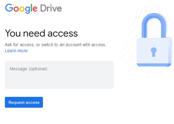

Благодаря! Получи се :)
https://drive.google.com/file/d/10Dj-EL ... gUzhqn9N2E
https://drive.google.com/file/d/12XzT57 ... k3Uw2SLAZa
https://drive.google.com/file/d/1lfdZpn ... BGKvQfZJi8
https://drive.google.com/file/d/1gISztF ... YuI-76pZkY
stefanjor - специалист
чет апр 15, 2021 10:48 amzMeeV написа:
Линковете явно не са публични:
