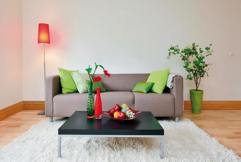

Тук се пообъркаха нещата. Става въпрос, за това от снимката. Другото са свободни съчинения.
Имал съм удоволствието, да живея в жилище, с изградена такава система за отопление. Комфорта е несравним. Напълно функционално, с достатъчна мощност. Идеално за нискотемпературно отопление. Превъзхожда и радиаторното, и подовото отопление. Единствен недостатък е високата му цена.
В старанието си някой се позагубиха в превода...
...Studies carried out by the KTH Royal Institute of Technology in Sweden investigated the efficiency of radiant skirting boards compared with conventional radiators. The published report detailed the findings that showed radiant baseboards are capable of having a higher heat transfer ability of 50% more than panel radiators. The research also shows the compatibility of heated skirting boards and heat pumps to be more effective than using traditional radiator panels in a heat pump system.
Heated skirting boards benefit from two key characteristics, the first being their low fitted position causing a high transferred convective heat flux from the skirting board to the room air. Secondly, due to being installed at the base of the walls they are exposed to colder room air along their entire length which in turn increases the thermal gradient and its ability to transfer heat to the room. This results in the radient baseboards having a much higher mean heat transfer coefficient of 12.6 W/m2°C compared to the 8.4 W/m2°C of conventional panel radiators...
...Response times and even comfortable heat all around the room at low level, means that typically ThermaSkirt is at least 13% more effective and energy efficient than steel, and up to 25% more efficient than cast iron radiators...

Системата "thermal skirting boards" по същество е инфрачервено отопление, и притежава всички плюсове и минуси на известните
системи с отоплително инфрачервено карбоново нанофолио, или уреди с карбонови вакуумно-тръбни нагреватели, или газови излъчватели.

Другояче щеше да звучи, ако г-н Ахмаков беше показал автентични снимки на собственото си жилище със системата "thermal skirting boards",
илюстрирана хронологично в стил "Направи сам". А не очевидно рекламни от мрежата. Защото се забелязва липсата на г-н Ахмаков на дивана, предполагам и от жилището.

В темата, освен твоето, има изразени и други мнения. Показани са конструкции, които нямат нищо общо, с това което се коментира. Направени са изводи, с които не съм съгласен. Което не означава, че твоето мнение е коректно. Да сравняваш "thermal skirting boards" с отоплителни системи с инфрачервено карбоново нанофолио или уреди с карбонови вакуумно-тръбни нагреватели...по тази логика и панелните радиатори, а защо не и чугунените радиатори може да ги причислим към тях, с всички плюсове и минуси.
Аз намерих този цитат:
profy написа:
...Невисоката ефективност се дължи на един напълно отрицателен ефект. Издигането на слой топъл въздух успоредно на стените, с по-висока скорост от
обикновената стайна конвекция, ще доведе до увеличаване на коефициента на частен конвективен топлообмен от вътрешната страна на стената, казват му ALFAin във формулата за сложно топлопредаване през външна стена (прозорец). Това съвсем директно и СЪЩЕСТВЕНО ще увеличи коефициента на топлопредаване
през стената, с други думи ще увеличи загубите. Ефектът на топлинната завеса е пренебрежимо малък. Това обяснява ниската ефективност от 13% спрямо
примерно 40% на ИЧ-отопление с нанофолио, спрямо конвенционалното отопление....
Този не можах да разбера от къде е и какво искаш да кажеш с него.
profy написа:
Инфрачервеният первазен отоплител ...ефективност от 13%... спрямо конвенционалното отопление.
А това, би трябвало да не е мой цитат, а на
KTH Royal Institute of Technology in Sweden написа:
което по никакъв начин, не съвпада с това което твърдиш. Освен това и изводите ти за "ALFAin във формулата за сложно топлопредаване през външна стена" са абсолютно погрешни. При сравнение със конвенционалното отопление, тук температурната разлика между таван и под е не повече от 1К, а при конвенционалното е около 5-6К. Възникват въпросите, кога скоростта е по голяма и къде загубите ще са по големи.
Действително се говори за увеличение, ама на "heat transfer coefficient" от 8.4 W/m2°C на 12.6 W/m2°C. И това се отнася за "thermal skirting boards", а не за стената. Надявам се, не се бъркат двете понятия.

Това предполага минало свършено време. В момента не живея там, но жилището все още е моя собственост. Та, ако има желаещи, да ми покрият разходите за направата на снимки, как седя на дивана, не този от снимката, моя е много по хубав, ще се радвам да ги споделя с вас. Това включва самолетни билети и кола под наем за седмица поне. Другите разходи ще си ги покрия аз. Но като знам, какви са пенсиите в България, много се съмнявам това да се случи...

По-вероятно предполага минало небивало време.
Защото сградната агенция може да направи снимки със свои представители на дивана и да ги изпрати.
Естествено с явен адрес за директна кореспонденция.
