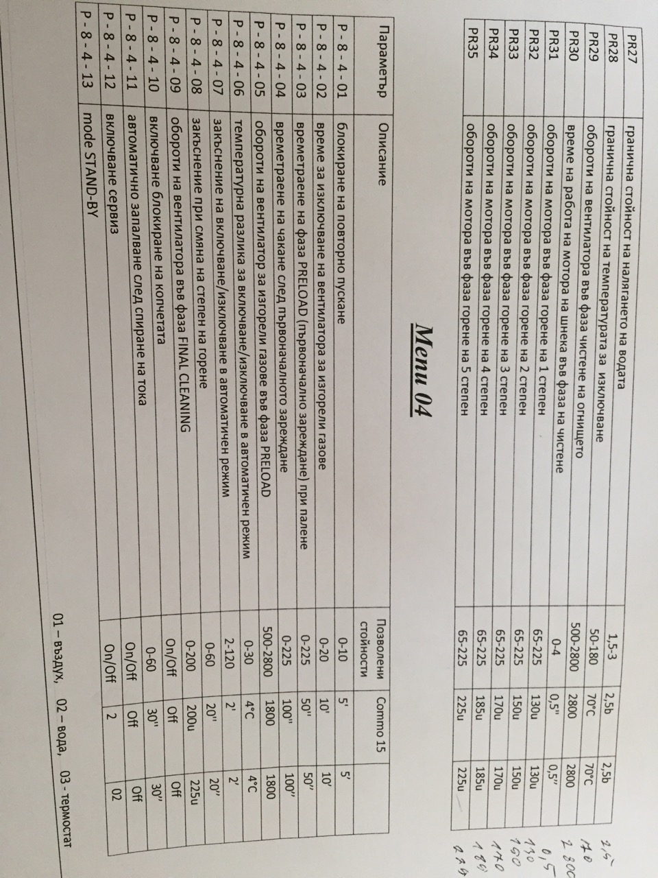

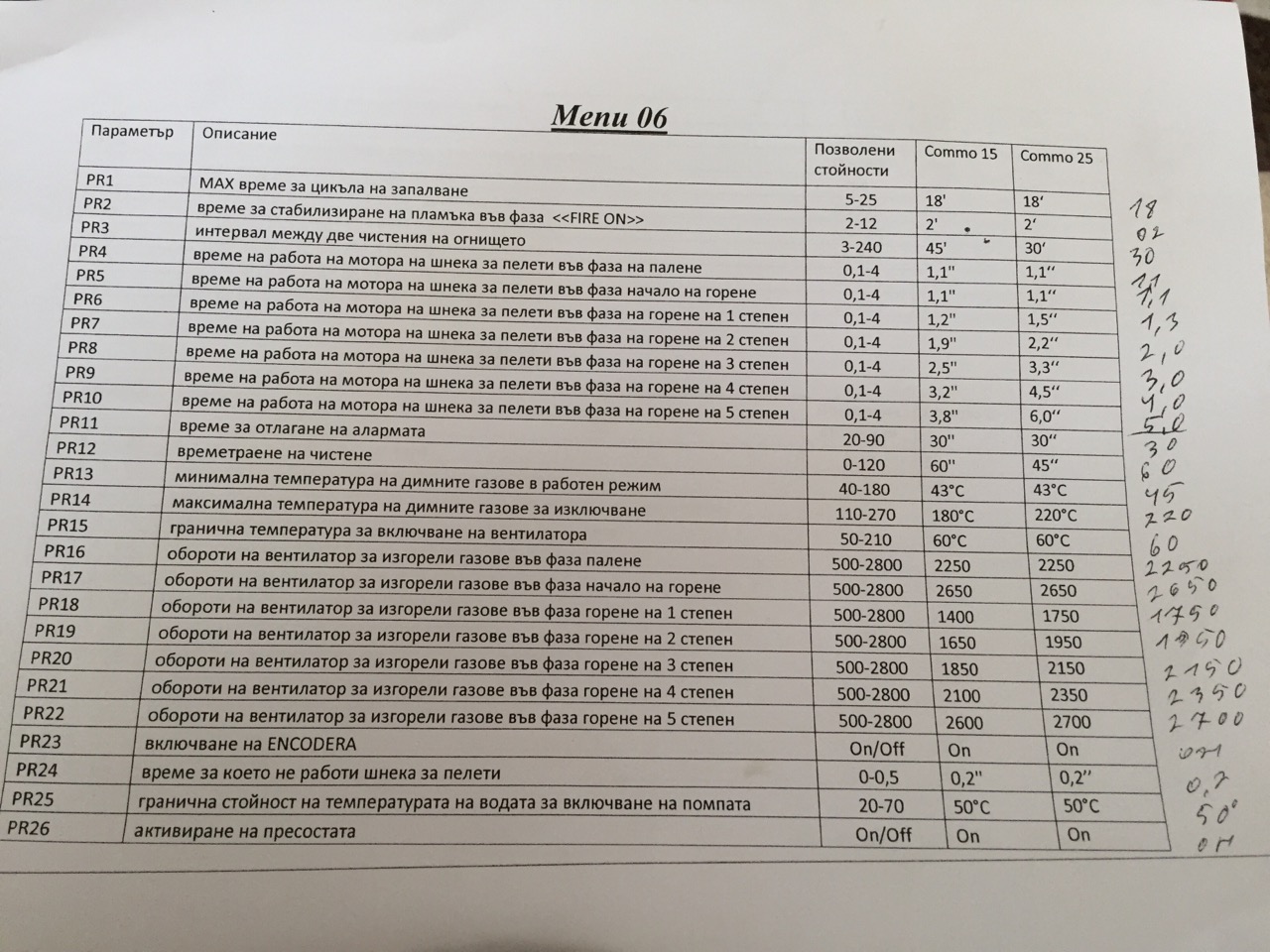

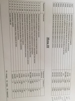

... малко късно открих темата във форума. Ползвам Commo-21 за първа зима, ето и моите настройки в "меню 8"
n-8-1 Type pellet
n-8-1-01 Load pelet - 01
n-8-2 Tupe Chimney
n-8-2-01 Ecxaust Chimney - 03
n-8-3 Bank Data 00
n-8-4 Settings General
n-8-4-01 Halt Restart - 05’
n-8-4-02 Asp-Min Spento - 10’
n-8-4-03 Preload Light - 50”
n-8-4-04 Waiting Fire - 100”
n-8-4-05 Exh-Spee Preload - 1800
n-8-4-06 Differen Off Auto - 04,5ºC
n-8-4-07 Del-off Auto - 04’
n-8-4-08 Change Output - 20”
n-8-4-09 Exchang Cleaning - 225U
n-8-4-10 Frozen Keybord - off
n-8-4-11 Black Out - 30”
n-8-4-12 Time Service - 1500
n-8-4-13 Modo Stand-By - 02
n-8-5 Test Outpust
n-8-6 Settings Factory
n-8-6-01 Minutes Time Out - 18’
n-8-6-02 Minuti Start - 02’
n-8-9-03 Cadence Cleaning - 20’
n-8-6-04 Auger Light - 1,1”
n-8-6-05 Coclea Start - 1,1”
n-8-6-06 Coclea Pover1 - 1,1”
n-8-6-07 Coclea Pover2- 1,6”
n-8-6-08 Coclea Pover3 - 2,5”
n-8-6-09 Coclea Pover4 - 3,0”
n-8-6-10 Coclea Pover5 - 4,0”
n-8-6-11 Dely Alarm - 30”
n-8-6-12 Duration Cleaning - 90”
n-8-6-13 Threshol Minimum - 45ºC
n-8-6-14 Threshol Maximum- 220ºC
n-8-6-15 Thresol Blower - 60ºC
n-8-6-16 Exhaust En-Start - 2250
n-8-6-17 Exhaust Engi-Avv - 2650
n-8-6-18 Exhaust Engine1 - 1600
n-8-6-19 Exhaust Engine2 - 1800
n-8-6-20 Exhaust Engine3 - 2000
n-8-6-21 Exhaust Engine4 - 2200
n-8-6-22 Exhaust Engine5 - 2550
n-8-6-23 Encoder - on
n-8-6-24 Time Breaking - 0,2”
n-8-6-25 Treshol Pump - 50ºC
n-8-6-26 Exclued Pressure - on
n-8-6-27 Treshol Pression - 2,9b
n-8-6-28 Treshol OFF - 78ºC
n-8-6-29 Exh-Spee Cleaning - 2800
n-8-6-30 Auger Cleaning - 0,5”
n-8-6-31 Speed Blow1 - 130U
n-8-6-32 speed Blow2 - 150U
n-8-6-33 Speed Blow3 - 170U
n-8-6-34 Speed Blow4 - 185U
n-8-6-35 Speed Blow5 - 225U
n-8-7 Reset Par-Time
n-8-8 Reset Alarm
n-8-9 Memory Counters
Това са настройки след като помолих от фирмата която ми е инсталира да дойдат и да намалят малко мощността по степените. Първоначално на 4 и 5 имах чувството, че ще излети.

bmahob написа:Искаш ли помщ в намаляването или си я разучил?Да съм я разучил ... колко да съм я разучил!?
Освен цялостното коригиране на времето на работа на шнека в някакви "+" "-" стойности (предполагам проценти спрямо стандартно заложените), виждам че мога да променям времето в и за всяка степен по отделно - там не смея за барам, за да не започне в определени степени да се задушава или да няма пелети за горене, а и не знам какво точно настройват менютата "n-8-6-04 Auger Light” и "n-8-6-05 Coclea Start”, за останалите "Coclea Pover" от 1 до 5 предполагам, че е времето за работа на шнека в секунди, но през какъв интервал включва не знам (засичам го на около 4 сек.)
Има ли и други опции които настройват подаването на пелети?
