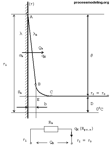

ivanovbg - майстор
я разгледайте тази диаграма.
И малко помислете за това:
t1 – temperature of the wall
t2 = t0 – temperature of the environment
qk – thermal flow of convection
Sk – the surface on which the thermal transfer through convection takes place.
Thermal section AB – laminar movement of particles with temperature gradient dt/dx = const.
Section BC – transition from laminar to turbulent movement.
Section CD – turbulent movement in which dt/dx = 0 and t = ¦(x) = const
Rk – thermal resistance of convection.
