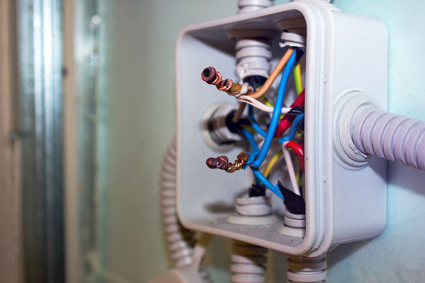

BS 7671
7.3.2 Walls
Кабели, вкопани в стена на по-малко
от 5см трябва да са в метална тръба
или гофре.
Ауууууууу!
7.3.2 Walls
Where a cable is concealed in a wall
or partition at a depth of less than
50 mm from any surface it must be
enclosed in earthed metal conduit
(trunking or ducting)
или гофре.
Ауууууууу!

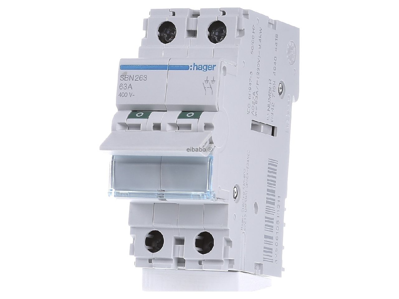

SECTION 5. ISOLATION AND SWITCHING
5.1 Isolation
Главният прекъсвач за монофазни жил. главни табла,
трябва да е двуполюсен, да прекъсва едновременно
фаза и нула.
Въййййййййййй!
5.1 Isolation
Means of isolation should be provided as follows:===================================
at the origin of the installation, a main linked switch or
circuit-breaker should be provided as a means of isolation
and of interrupting the supply on load. For single-phase
household and similar supplies that may be operated by
unskilled persons, a double-pole device must be used for
both TT and TN systems.
фаза и нула.
Въййййййййййй!
